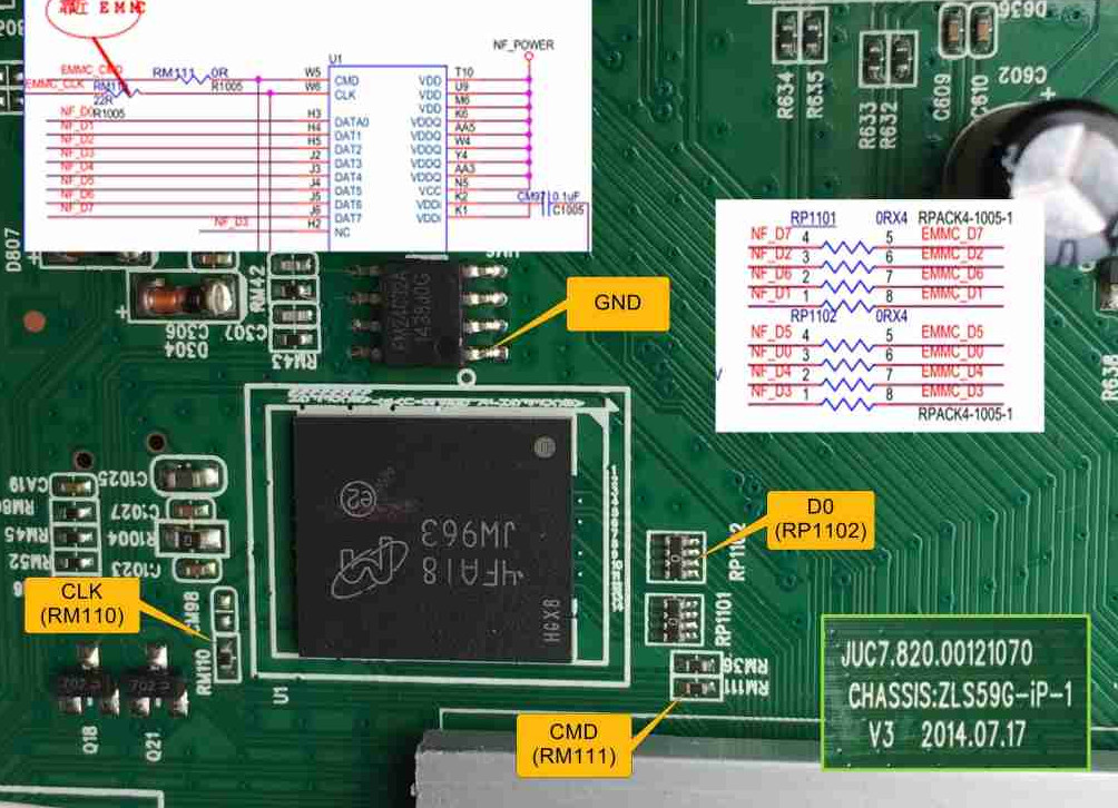

Changhong JUC7.820.00121070

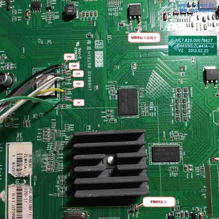

Changhong JUC7.820.00078827

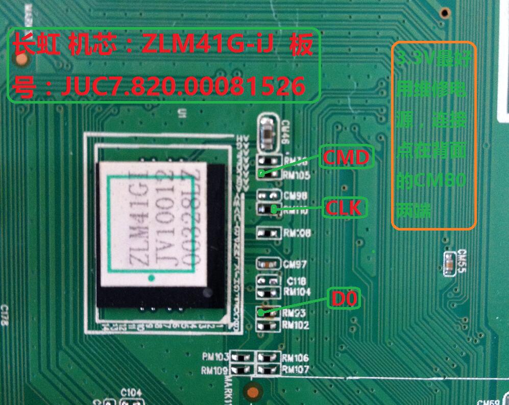

Changhong JUC7.820.00081526

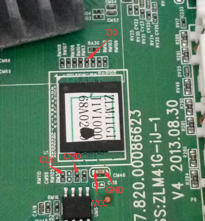

Changhong JUC7.820.00086623

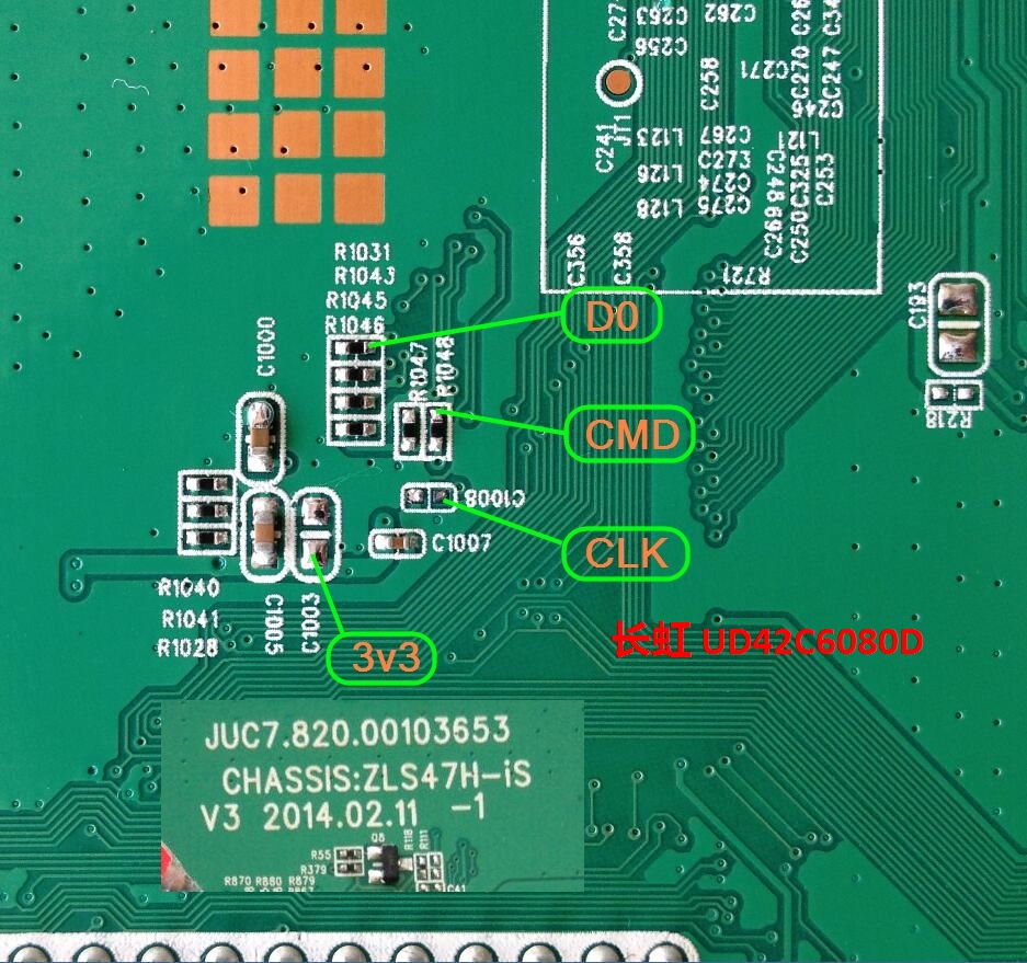

Changhong JUC7.820.00103653

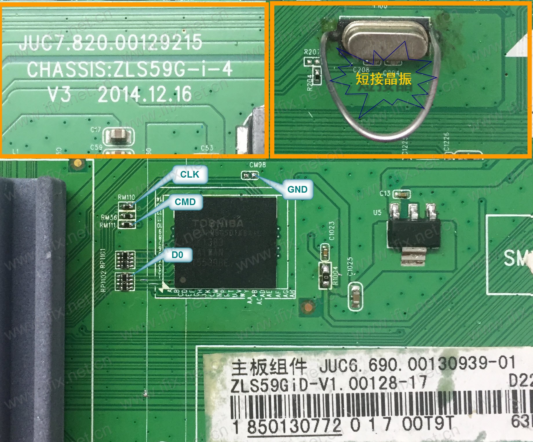

 楼主| 发表于 2023-5-13 17:04:18 | 显示全部楼层
Changhong JUC7.820.00129215

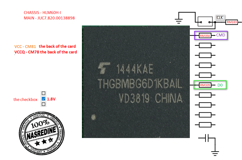

Changhong JUC7.820.00138898

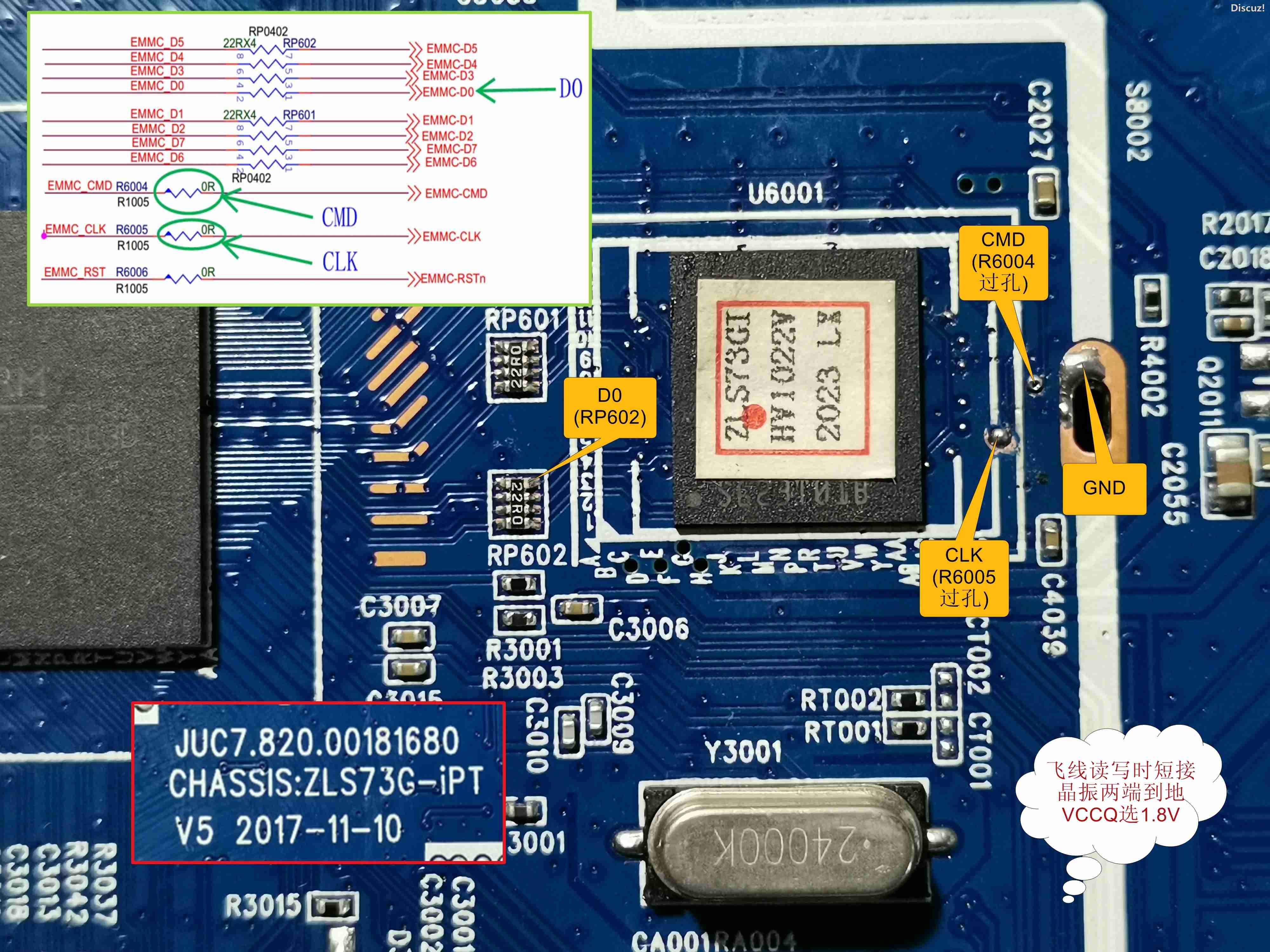

 楼主| 发表于 2023-5-13 17:06:42 | 显示全部楼层
Changhong JUC7.820.00181680
