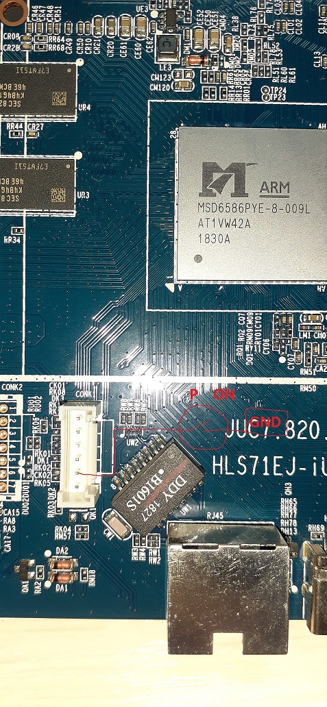

 楼主| 发表于 2023-5-13 17:07:18 | 显示全部楼层
Changhong JUC7.820.00210955

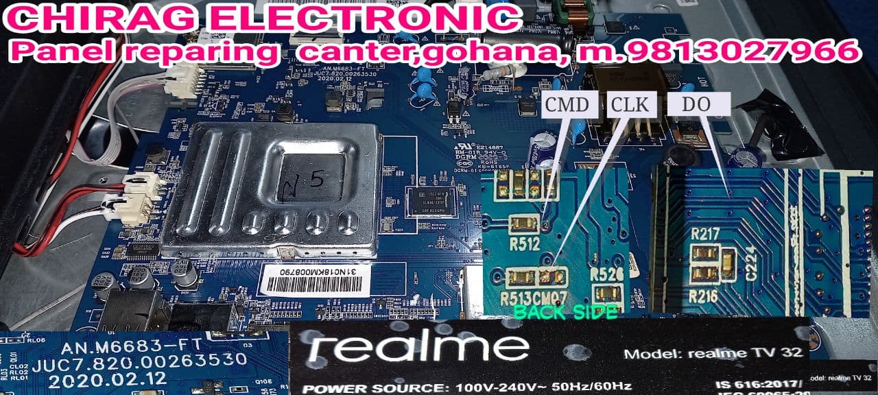

 楼主| 发表于 2023-5-13 17:07:49 | 显示全部楼层
Changhong JUC7.820.00263530

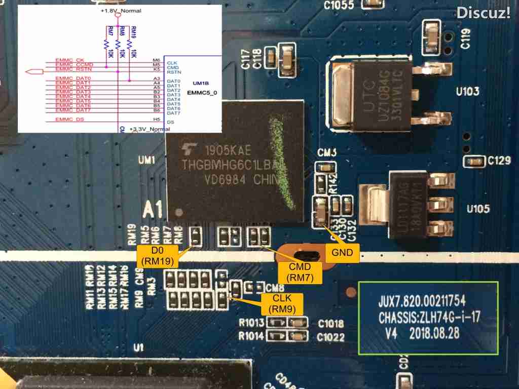

 楼主| 发表于 2023-5-13 17:08:20 | 显示全部楼层
Changhong JUX7.820.00211754

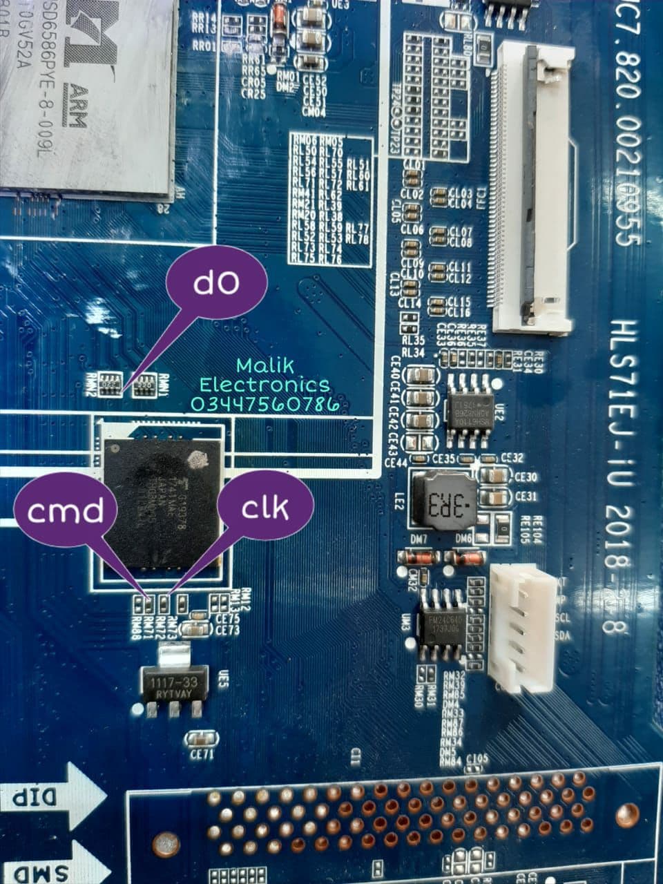

 楼主| 发表于 2023-5-13 17:20:44 | 显示全部楼层
Changhong JUC7.820.00220855

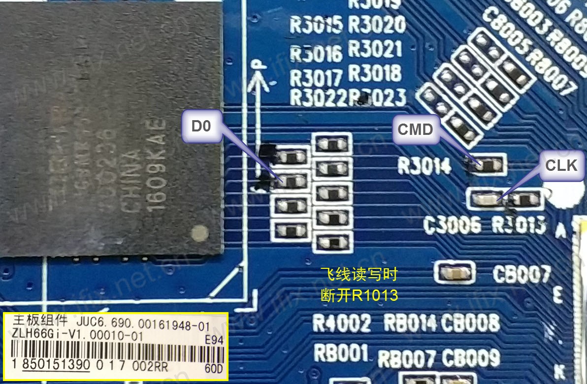

 楼主| 发表于 2023-5-13 17:26:04 | 显示全部楼层
Changhong JUC6.690.00161948-01

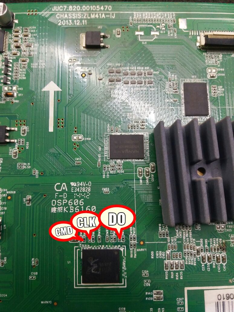

 楼主| 发表于 2023-5-13 17:26:33 | 显示全部楼层
Changhong JUC7.820.00105470
